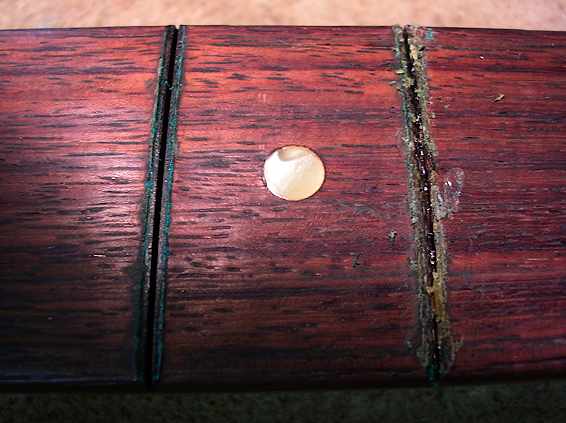

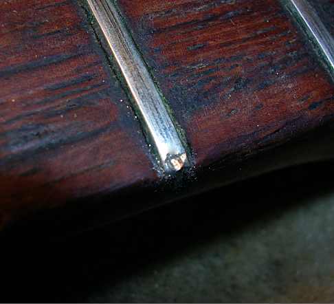

I start with a small bit in my Foredom to grind a small notch in the bass
end of the fret. It's a good idea to place a metal guard right next to the
fret, just in case the bit decides to go for a walk (a lesson I only had to
learn once, long ago).
Here's the first notch, cut at a shallow angle with a nice flat end.

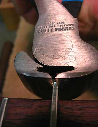

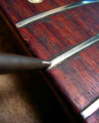

Then I tap quite firmly on the end, using a punch on which I ground the tip
flat and crudely turned down to the same size as the cutting bit. A sharp
punch or scratch awl make work as well, but fret metal is soft, and I like to
have as broad a surface as reasonable spread the pressure as I drive it out.
Here is about as far as I'll drive it. They start out a bit tight, but once they
start moving they will slide right along. Perhaps 40 years of green grunge
helps lubricate.

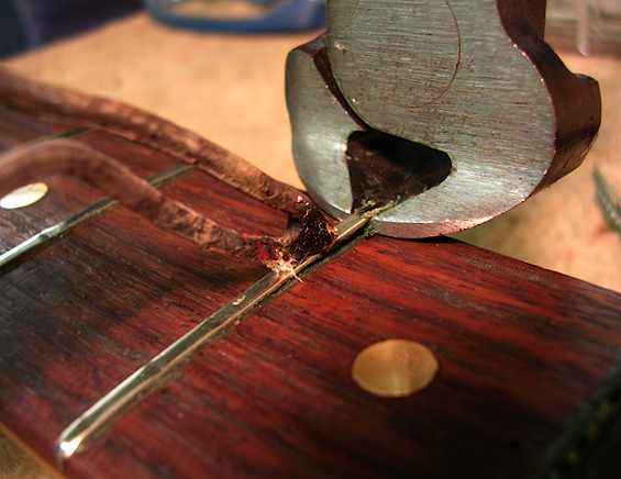

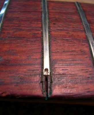

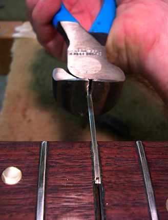

Here is the fret leaving the treble side. Though they often come out quite
clean, you do have to watch for chips pulling loose and take care as pulling
it out.
Then I grab with my nippers/pullers, and gently begin sliding the fret out.

When pulling the fret, try to remember that the barbs have essentially cut a
channel in the sides of the slots that they like to stay in. Keep the fret wire
pulling along it's radius if that makes sense, rather than pulling in a
direction that will lift the bead away from the board.
PostPosted: Thu Nov 01, 2007 4:26 pm
Posts: 2060

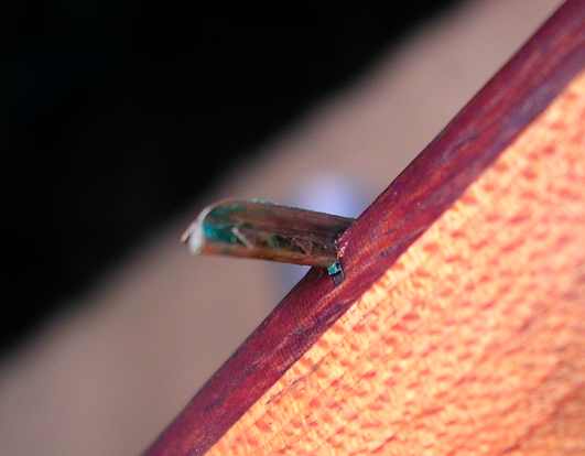

For about the last 1/4" or so, I like to set the pullers aside and draw the last
bit out by hand. Most of the bad chips that happen will fly off in that last
spring of the wire exiting if you are hasty pulling it out. It's not terribly
delicate, but it helps to be slow and careful there. This one had a few small
chips, all of which were easily fixed with a dab of low viscosity CA as soon as
I get the fret out.

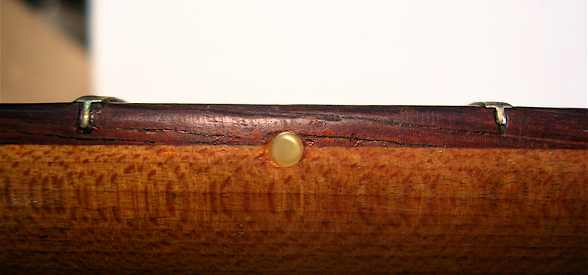

Of course, if it's been refretted, they went in through the top and will have to
come out the same way now. Notice the difference in tang between the 4th
and 5th frets as a dead giveaway of a partial refret.
So here it's back to my dirty old solder gun and pullers as normal.
